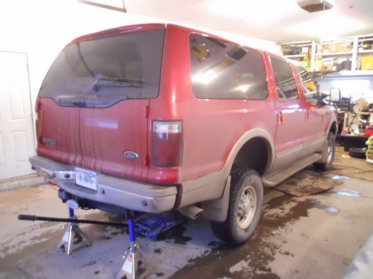

do exactly as he said. undoing the sway bar is the key. i mean even NCexpy did his. haha just use a bottle jack and put it between the axle and body or frame. and start jacking till theres plenty of room to put the spacer in. and WALA your good to go.

i was planning on doing it more like this panda seems safer lol this is when i did my lift blocks in the rear of the excursion.

keep it on level ground. take a bottle jack and stick it inbetween the axle and frame or body. and start jacking. you might get lucky and be able to stick inbetween the coil and body, but you may have to to disconnect the sway bar. if you do, not a big deal. just torque it to spec when your done. just undo one side. that might be all you need to do.
