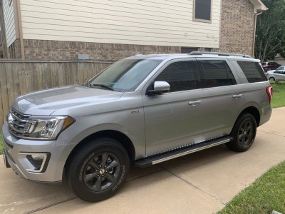

It’s about 79.5” measuring at the front portion of the roof rails. I don’t have any decent pics yet as I just put it on last night. I have already purchased the Bilstein 5100 set except with F150 fronts. Factory shocks in the front are leaking and I certainly won’t be going to the dealer for that, non ccd here.

That's with the 3/2 ReadyLift only. They will be coming back out once the shocks get here. I went with the F150 fronts as they provide more lift in the front than the ones that Bilstein lists on their site for the Expedition and my wheels/tires would not clear with the ones specifically for the Expy. I'm thinking I will have the rears set at the max 1.5" (possibly with a 1/4" or so shim to prevent cali lean) and the fronts either at the 2" or 3" setting. I ordered the 5100s for the Expy from shockwarehouse.. and the F150 fronts from the cheapest place I could find online, several places selling them.
