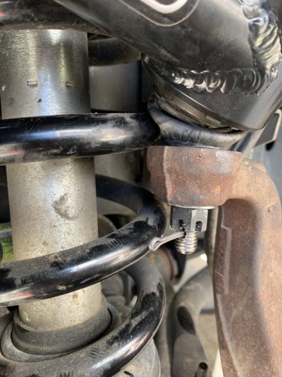

Here is what I look like with 5100s and BDS upon install.
That is the knuckle underneath the coil but the arm does not contact the coil. with factory UCAs the inside of the UCA hit the coil but the knuckle does not bind like above.
Now this is prior to any load being put back on the suspension without tightening everything to spec.
I did not like the idea of it binding under the spring vs. just the arm to coil contact.
So I pulled it off as I did not have a full day to install, uninstall, and reinstall to find out if I was good.
I sent the pics to BDS and they said that “it should” pull itself out under load and be good.

As for BDS and 5100s I took that picture above as it is my truck.
I had to pick my kids up in a bit so I did not have time to hope it would work, which it very well may.
I was not comfortable with it at that point because I did not have time pull it all out again if it did not move out from under the spring so I put the stock arms back on because I know my only issue with factory arms is a clunk at full droop and not physical binding like shown in the picture.
I have not had an opportunity to fully disassemble and reassemble everything to test it. So I can’t say for sure it won’t work.
If one did not have to pull the coil over to get the UCA bolts out it would be a much shorter task.

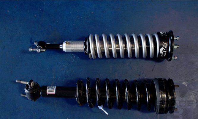

The issue for us is these parts are designed for F150s and while they fit. The spring rate of the Expedition is slightly different so it has some different effects and the fact that in most cases at full droop even with no contact we’re talking like 1/4” of clearance.
The Fox Unit is a touch shorter and the spring has a slightly smaller diameter which is why there is more room.
In the picture that is a factory coil over. The coil over with a 5100 is even slightly longer at the bottom than the factory unit which is likely why the 5100 does play as nicely with the BDS Arms, or factory arms compared to the Spacer kit since the height is added to the bottom and not the top like the spacers.
Just enough difference in geometry to give us issues since we are talking a very little clearance area any way.
