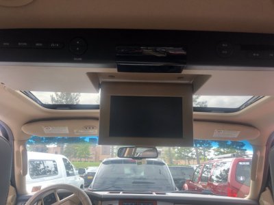

It's worth a few minutes with a laptop and Forscan. As I write this I have not wandered off the reservation, I am addressing the heated steering wheel discussion, and there is method to my madness. I have a 2016 Platinum Expedition EL, it has all the foo, foo, bells and whistles excluding the rear, second row, dual screen DVD/Gaming system. I was glad it did not have that, not so thrilled, it has the factory, glass, power Tilt/slide Moonroof, seriously, this HUGE, MASSIVE, OVER THE TOP, LUX people mover/field office/camper has the factory, glass, power Tilt/slide Moonroof. Last time I encountered a vehicle with a, "Moonroof," was my moms 1977 Lincoln Town Coupe! Mom's Moonroof, was a burgundy tinted, (to match the car color), power operated, sliding glass panel. It was trouble free, water tight, well designed, and proportioned properly, it was a very nice option, not only fitting in with the size of the vehicle, but complementing the vehicles appearance. Flattering the look, of the 1977 Lincoln line of Town Cars, and Town Coupe's. None of this is true with my Moonroofed, Platinum Expedition EL. The Moonroof on the 77 Lincoln Town Car, and Town Coupe, is at least two or three times the size of the one in my Expedition EL. The Lincoln Moonroof was properly proportioned, correctly sized, and fit in with the vehicle size, complementing it's style, and appearance. I am clueless as to why any Expedition EL needs a Moonroof, especially one totally out of proportion, with the size of the Expedition EL! The visual of the installed product is hilarious! Like a puppies body trying to grow into its too big and awkward head size. I am not embarrassed by it and chuckle over it every day, I will never be able to figure out, why Ford Design went this way, with something so amusingly out of balance, and out of place. Hmm, perhaps it could be Fords better idea for a fancy, power glide, open/close doggy door to the stars! Almost as big a design misstep, as the Moonroof, and equally as amusing, is my Expedition EL's rear window wiper! Ford made that thing so big! The wiper hardly ever works! It always hangs up, gets stuck, as it struggles to swipe passed the 12:00 position on the liftgate glass! If you lighten the blades pressure against the glass it streaks, smears, makes more of a mess than it removes. Increase the pressure and the blade hangs, if there is a sweet spot I have yet to find it. Its not the motor, I replaced that with the new blade installation end of winter. This interior of my Platinum Expedition EL is very, very, very nice. Black leather seating, excluding the third row, black faux leather, (Vinyl) there, black headliner, all offset with the grey door, and dash accents. The word Platinum discretely visible stitched into the first and second row seat headrests. The first time I looked from the drivers seat, back through the vehicle to the rear, the incredible job Ford did with this part of the vehicle, reminded me of the view from the pilots seat, to the rear of the cabin, in a Beechcraft Baron. Both elegant, tasteful, beautifully done, obviously something a lot of thought went into.

The moonroof is about as big as it functionally can be. The DVD/Entertainment center is right behind it in my Eddie Bauer EL.
