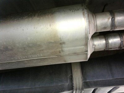

I stayed with the 2.5" pipe but cut out the factory Y and installed the Flowmaster 524703 it is the 70 series so not really loud but still sounds good. By putting this in and getting rid of that Y I picked up 100 miles to the tank (but only if I can keep my foot out of it, which can be hard because it sounds good :D ) The Flowmaster 524703 is a dual 2.25 in and a single 3 out really helped my 5.4 with power while towing as well. The best part it only cost me $175 for the muffler and pipe plus the spindle nut to use as an o2 sensor bung, a 12 pack and a few of hours with a buddy and a mig welder :D I also got rid of the resonator in the back with the left over pipe, it sounds great and you barley even notice it while on the interstate ( our speed limit here is 75 and I am turnin 2200 rpm my wife and daughter have no complaints)
