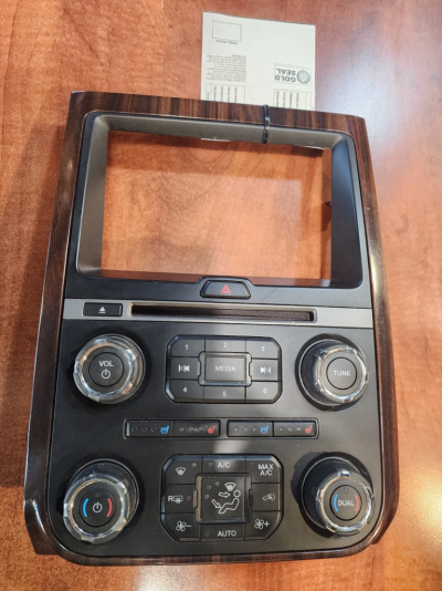

Hey y'all! As the description says, I have a '16 Platinum, and am having issues with my center console controls. The Sync screen works fine & I can cycle radio stations, source, etc fine on the screen. Volume controls on steering wheel working fine. However, none of the climate controls work on Sync screen, none of the manual climate controls work, and none of the radio manual controls work. Heated/cooled seats, power, tune... all dead. Checked alll fuses I could find relating to the hvac & radio system - all seem to be ok. Has anyone experienced this and/or have any suggestions as to what my issue may be? Thanks!

Cowboy183
Mar 10, 2025
Pennsylvania
