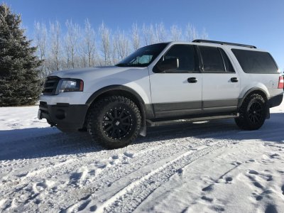

If you're doing a 35, stick with the stock offset. I've got a 32.5 inch tire that'll rub on -24. Looks good but is the stock height, just wider and offset rims.
Canuckid
Dec 26, 2017
Canada
Thanks, the wheels are xd heist 18x9 +30 offset. They are almost flush in the rear but stick out a little in the front. Especially when viewing it from the front of the vehicle.
