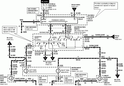

wiring prints for fuse #23
remove the flasher relay and then drive the expy
however you will not have turn signals while the relay is out.
But that shouldn't matter as most drivers don't use them anyway
if fuse #23 doesn't blow then your problem may be the multifunction switch
