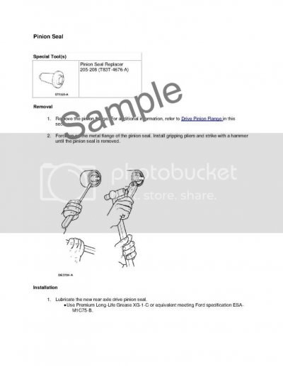

Pinion seal. Pinion flange file is too large.... can email.. :)

I found "free" pdf to jpeg converter online...lol. You would never know.. :)
If you would like I can email you the pdf version with out sample written across the page.
