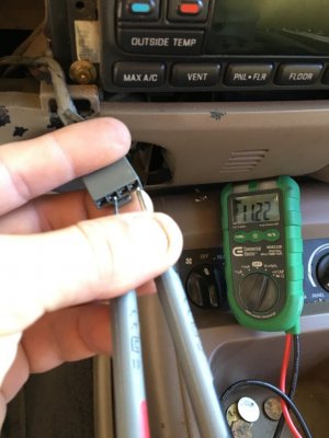

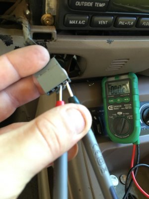

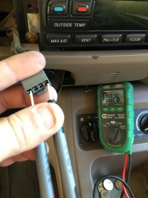

So here is a little update. Don't know if it would help diagnose it at all. I went and tested the voltages I was getting at my 4x4 selector switch. From what I had read, you should get about 1V for 4L, 2V for 4H, and 3V for A4WD. That is not at all what I am getting.
I believe this should be the reading for 4L
I believe this should be the reading for 4H
I believe this should be the reading for A4WD
Can anyone verify that my assumed readings are correct? Could anyone tell me why what I think is 4H is getting almost 12 and what I think is 4L is getting almost nothing at all?
If the selector isn't sending the right signal out to the transfer case on how to switch the gears, would that cause my issues of why I can reverse better in one 4x4 mode and not go forward and go forward great in another but not reverse?

wiring diagrams Check the selector switch for the correct resistance values

I can't get a resistance reading from the switch in any setting. I can get a beep telling me there is continuity in one setting but when I switch the meter to tell me the resistance, there is no reading. So I guess this means the switch is bad but could it be bad because the one setting is sending in the 11.2V? Also since that is so high, would that be what is causing the dash backlight fuse to pop?

This was copied from the Manual Sorry pics didn't copy but really not needed
B6 CHECK THE MODE SWITCH
Mode Switch C230
Rotate the mode switch to the A4WD, 4H, and 4L positions.
Measure the resistance between mode switch terminals 2 and 3 while rotating the mode switch through all switch positions; refer to the following chart.
  • Mode Switch Position Resistance Range
    A4WD 3,700-4,100
    4WD HIGH 1,040-1,160
    4WD LOW 340-380
  • Are the resistances within specification?
Yes
GO to B7 .
No
INSTALL a new mode switch. CLEAR the DTCs. TEST the system for normal operation.

Ok, knowing to use pins 2 and 3 made all the difference. The switch checks out fine.
Still doesn't explain why the dash backlight fuse pops when I turn the switch and why I don't have the 4x4 light illuminated on the dash when I am in 4H. At least I know one thing works.
