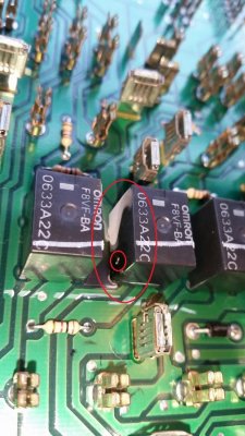

I installed a new Fuse Box ( 3L1Z-14A068-AA ) yesterday. I was going to move the Expy before starting the work, but it was a crank/no start, so I'm lucky I didn't take it anywhere!
Ordered from group1autoparts.com | Genuine OEM Parts Direct in OKC
Expy started right up after installing new fuse box, and seems to be running fine. In fact, it might just be me, but it actually seems to crank/start easier than before the repair.

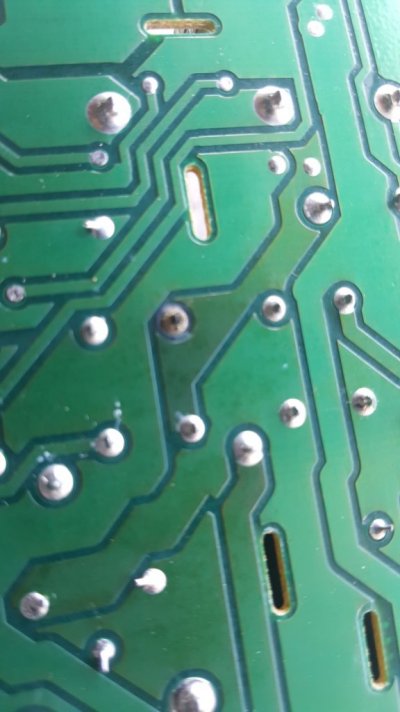

Attached pic shows PCB removed from fuse box, with area of burning/failure circled.
Thanks again to everyone.

The second gens have had issues with the fuse box / fuel pump relay, overheated connectors for fuses and a few burned traces. All easy repairs if you are able to solder and can source the smt relays when they are used.

Swapped fuse box and fixed it.

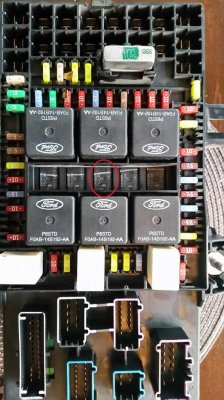

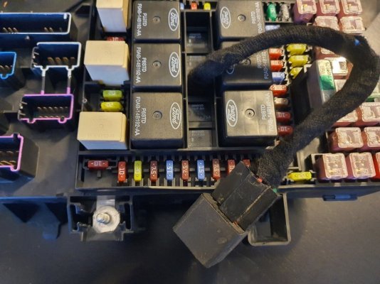

So my 2003 Expy just stopped running on the Interstate... dangerous situation like the GM recalls. So I had it towed to dealer. Dealer replaced fuel pump and filter for $1,400. Six days later it died again... crank and no start. So thank you to this forum for pointing out the relay. I took apart the fuse box and found the burnt relay and traces. Bought the whole fuse box and installed... not too hard and it started just fine. I am including pictures that show the burnt relay and also the new fusebox I purchased.
