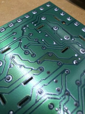

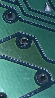

On my 2003 I went ahead as a precaution and just bypassed the fuse panel fuel pump relay completely. Do a Google search or search for the wiring diagram to figure it out. Use a good quality relay like Bosch for this.
I believe I used the grounding signal from the pcm that goes to the original relay as a grounding signal for the bosch relay. The output obviously goes to the green\yellow wire going to the fuel pump. I got constant hot by wiring a terminal into the post of the main terminal powering the entire fuse box in the passenger side floor area.
Of course I put an inline fuse in right where I tapped the main power terminal.
I thought about putting a small led on my dash somewhere that lights up when fuel pump is getting power but who knows.
So when the key is turned on the pcm sends a ground which closes my relay and sends power back to the fuel pump using the original wiring.
