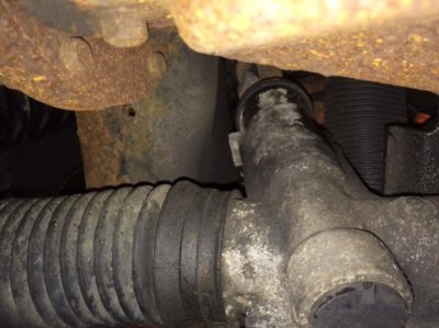

It is actually coming from inside the steering gear connection to the rod
Here is where he noise is coming from - does the rubber cover come off the steering gear rack to provide some adjustment?

Check for play in the inner tie rods, which are hiding under the boot you have pictured. Any play in them will manifest itself as a clunk over bumps.
The boot you have pictured does indeed come off. It's held on by a crimped band that will have to be cut off. Replace it after removal though as you need it to seal out dirt/water. A hose clamp works fine. There is no adjustment in there per-se. The inner tie rods live in there though and I suspect you have one (or both) that are worn.
It is highly unlikely you have a problem with the rack itself.

Yes, if you haven't replaced the inner tie rods and the lower ball joints yet I'd definitely look at those as culprits.

I was rally trying to show in the picture the round cover on the bottom of the steering shaft with 4 slots. I am not sure if that is a pre-load or something I can adjust. I do not think it is the inner tie-rod or the steering rod connected to the steering wheel. It sounds like it is coming from the rack somewhere. Again no play in the steering both off the ground or driving.
Is everyone elses rack completely quiet?

My Expy's steering rack is quiet. 160k miles and only thing I've ever done to the steering is replace the inner tie rods and ball joints. I would take it to an alignment shop and let them at least look at it for you.
