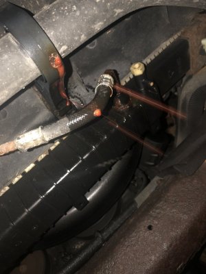

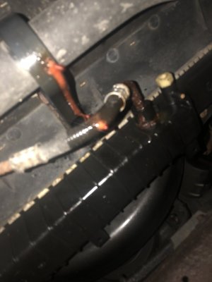

E43171A9-A2BF-4286-BCFC-5A8FA9E3EB04.jpeg AADB6194-3B69-49D2-84F0-9CAF4CAC5B11.jpeg 8E4FF1FA-4597-4021-BD48-2273295F1E5E.jpeg JUST PURCHASED THIS VEHICLE , NO POWER STEERING AT ALL CANT TURN WHEEL ONE BIT ALL POWER STEERING LEAKS OUT I FILLED THE RESEVOIR WITH FLUID AND IN 4 HOURS IT GOES DRY

You've got to narrow down where its leaking from. You'll need an assistant to turn wheel, while under vehicle to observe if its a hose, or pump, or where ever its leaking. Should have done that when you refilled PS fluid.

Your video looks like a high pressure hose that's gone bad. Replace that hose, that's easy.
