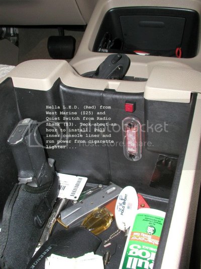

I got a flush mount Hella LED light from my local West Marine (or you can order online...) for about $25, and a Quiet Switch from my local Radio Shack ( $5 ). Pulled the inner console liner out and made the appropriate holes, and used tinned duplex wire to run power from the rear cigarette lighter to the light switch and light as needed. Took about an hour. Looks and works great now for almost ten years. The red LED works best so you don't blind yourself at night if you really need something in your console and don't want to lose your night vision :gunner: .
The small square switch mounted just above the light is very easy to find in the dark. It is powered all the time, just like the rear lighter. Another thing I found helpful was to replace the stock white bulb in the forward console ashtray with a red LED bulb, since it's on anytime the parking lights are on. The red LED runs much cooler, draws almost no amperage, and doesn't destroy your night vision if you or someone else opens the ashtray at night.
