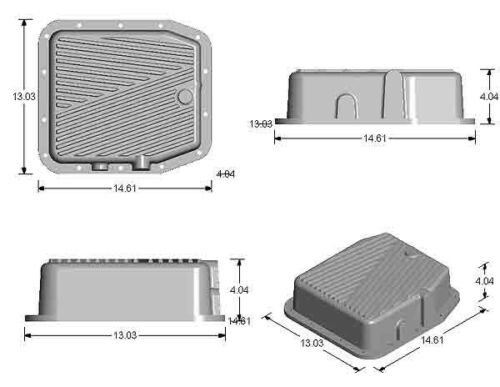

Long time ago I installed a PML aluminum deep pan ( 9685-2 ) on my Expy's tranny. It's made fluid changes so much easier and holds 2 quarts extra fluid. If you're going to pull the pan and change the filter anyway, it will make your future maintenance much easier and way less mess. I also added a tranny temp gauge when I did the install but that's just a nice to have thing for towing and overall information, it's not an essential thing. The deep pan does not hang below the crossmember, and it has a drain plug for easy fluid changes.

Thanks for this information. I plan on taking my truck into my mechanic and I will be taking this pan with me. After that, I can do mine on thing.
