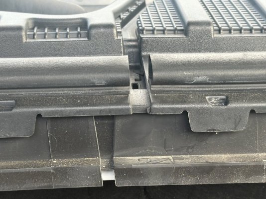

It looks as though the air inlet grilles were not installed properly. There are tabs underneath the plastic grilles.

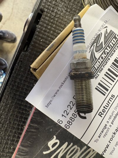

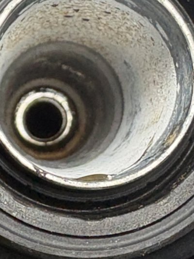

Yep! Similar problem on my '24 except that there was about 1" of water in the #1 spark plug tube. I was changing my plugs early 38K because I bought it used. Anyhow no cover over the engine so I just used dielectric grease where the coil seals to the tube. Will check it when I get back from my 4k trip. I noticed that the cowl cover does have a drain slot before the hood seal.
