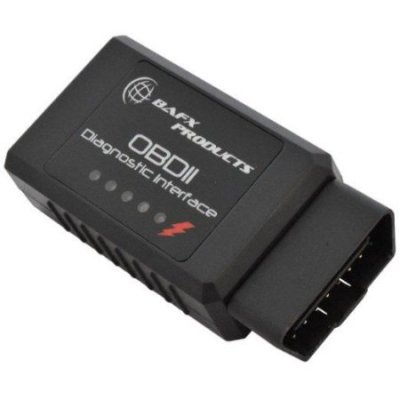

Your Bafx is a obd2 scan tool. I believe your torque light is also. Surprising you didn't get a misfire code for one of your cylinders? Something like p351 thru p358. Be sure your obd port has got voltage, theirs a fuse for it. You might also want to do, or have done a fuel pressure test. Seen a lot of weak fuel pumps lately. Report back what you find.

Plugs got changed @99K. I also asked for new wires (didn't know about COP) but not sure what I got. The way I looked at the problem is that it still could be a plug, COP, injector, or anything ... Stuff can fail at any point so I wanted to diagnose it to what is failing. I need to learn more about using the OBD2 tool, I just looked at logged, pending codes, & historical codes and it said no ECU codes. I'm on the road all week so ill look at it again this weekend. I think I have to go into sensors or something to see misfire & I might as well pay for full Forscan or Torquepro or both vs trying to use free version.

Bafx dongle is working, I can see lots of data .. Vacuum, rpms, etc. ... on my android. Must have power so that's not an issue.

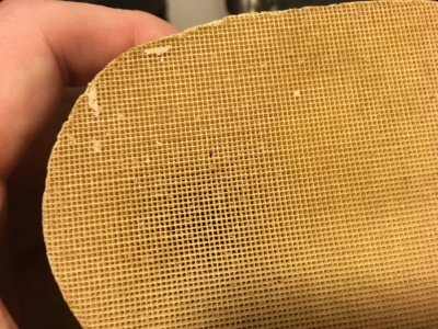

I have a connection to catalytic converters so I want to be nice to them. I worked at Corning Glass Erwin Ceramics plant around 1980. The plant was the first US manufacturer of catalytic converter substrates. They mixed up ceramic batch and extruded it through a die like play-doh then baked it in huge ovens. Revolutionized the auto emissions control and played a big part in clean air to breathe. Plant ran flat out and I was able to work double shifts any day I wanted for 2 years. Kept one for myself. Those tiny honeycomb channels get infused with a catalyst and have a lot of surface area.
