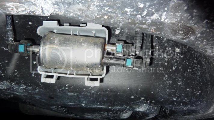

I have read about the fuse box problem. I have read about a fuel pump relay problem. I have a new fuel pump relay and fuel filter that I am waiting to put in, but I really think it is something electrical or ignition related.
