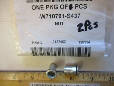

They're a "rivet-type" captured nut.... no headliner removal required.... unless you're unlucky enough to need to.

They are called Wellnuts and can be purchased in a good hardware store.
When removed, you can actually push through to the headlining, so it's just a simple hole drilled or punched through the roof at the factory. FYI, My first Expy was a '97 with the sliding track type roof rack. I had purchased Thule accessories for it to carry kyacks, skis etc. When I learned it was held by the wellnuts, I was able to detach and keep it when I sold the vehicle. The new owner didn't need it. I got an '05 second gen that had some cheep factory rack that was useless unless you spent at least another $80 for the factory crossbars that were only an option by then. Since even with those, none of my Thule accessories would fit, I removed the rack and found out that all the holes in the roof were in the same position as the older Expedition and the old rack would fit without drilling new holes. This might be because the second generation, 2003 - 2006 had the old rail style rack of the first gen until my year, 2005. So you might want to find one of those in a junkyard.
