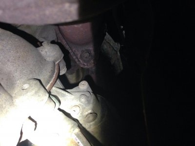

I have an 07 that was experiencing similar issues. Noisy startup and ticking under load and an occasional hesitation. 180000km I replaced the plugs but didn't expect this to resolve the issue.
My solution is twofold: MAF sensor, as diagnosed by ford. I tried cleaning it but it ran 100 times better when it was changed.
Next, I only just found that my #8 cyl (pass side at firewall) is leaking exhaust at the manifold. Also the heat shields on not sides were completely loose and rattling around. I could see the gasket was bent from looking through the week well but no sign of trouble until I looked underneath.
This is my to do list so I'm looking for advice on the replacement of the manifolds.
The MAF sensor wasn't too expensive and not a ford OEM part.
Also I don't think these 3V engines have EGR or phasers anymore due to VVT, but I could be wrong.
Good luck
