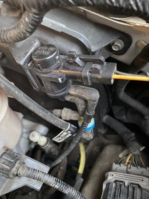

does anyone have a picture of where this is located. I did a scan with forscan and have this code c1979. 2016 expy. not giving a indicator on the dash. But when I turn the 4x4 switch it seems to work. I can clear the DTC then throw the switch and it come back. Thanks for any help with this.
