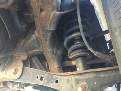

Thanks all. So I looked underneath- if they're struts, do I need to replace the coils, or can I reuse and just get the shocks they're wrapped around? Don't mean to be so dense, just want to get the right parts. Gracias.
Keep the coil springs and just replace the shocks and probably the strut top/bushing. Your will need a spring compressor though to do that. If you can't get or dont have a spring compressor just find complete assemblies(strut,coil spring/mounts/bushings) that can be bolted right in

It would be the same process you followed for your fronts. You can borrow/rent coil/strut compressors from your local parts store or if you had someone else swap the front just get them to do the same for the back.
I believe the bilstein part for the back shocks from reading some other threads on here is
24-197724
You might want to replace the spring insulator (sits on top of your coil spring under the top mount)
But I'm not sure what the lifespan of these is? With your mileage you might be fine.
Ford part number is: 7L1Z-5536-A
If you decide to replace the whole complete strut assembly with new springs and everything just make sure the manufacturer will warranty them for use on the EL. Several of them wont from just going through it myself and talking to several. Two that I found would for sure were strutmasters and American air suspensions.
I ended up buying a set of stock complete assemblies (like what you are running now) to convert over from my air suspension as I wanted to make sure I had the correct coil spring rate for the EL. I will eventually rebuild them with bilstein stocks like you are planning to do.

I went with rancho quick adjustable strut. I found out after I bought them that the springs are softer than stock through a question on issues I had. Out of the 4 I ordered 2 were incorrect and to be sent back. So try to keep your stock springs. Most shops will transfer your springs for a fee or rent the spring compressor tool. Also I would recomend a impact gun. It makes the removal easier. Lastly do not tighten the struts completely till you have put weight on it.
