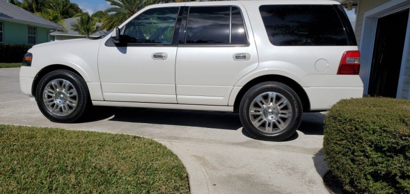

Here are measurements taken this AM with the 2011 truck I reference above and our 2017. The measurement is from the ground to the bottom of the fender lip. Both are Standard Length Limited 4x4 with HD Trailer Tow, 3:31 open differential, 20" wheels and the same size (not brand) 275/55/R20 tires. I've also provided pictures where you can see the rake on the 2011.
2011
Right Front 33 3/4"
Left Front 34 1/4"
Right Rear 35"
Left Rear 35"
2017
Right Front 36 1/16"
Left Front 35 15/16"
Right Rear 35 1/8"
Left Rear 35"
