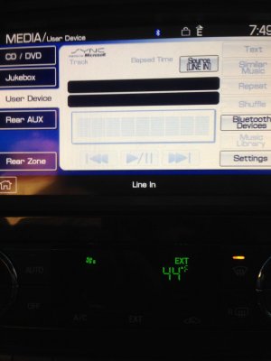

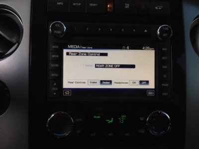

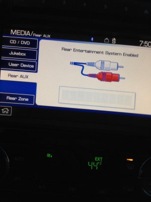

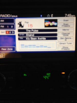

Sorry, my bad. I have a 2013 Expedition EL that is a FLEX fuel vehicle, lol. I guess that won't matter. I am including screen shots of the unit.,Sry

Does anyone out there have the factory installed rear entertainment system that looks like the one above? Preferably a 2012-2014.
