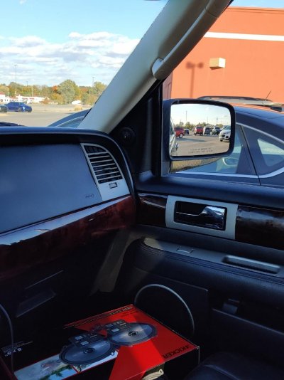

Thanks for the feedback, After reading reviews I decided on JBL Stadium GTO860C. 6X8's will fit perfect and the tweeter will fit in the original location.
Where is the best place to mount the crossover? Is there a nice spot in the door it will fit?
Any or all recommendations are appreciated. My Christmas gift for the wife so I am trying to get a game plan so I can get them installed Christmas day.
Thanks

put the xover wherever u want...when i initially amp'd my doors i put the amp in the spare tools location under the panel...had a 1600x4 in there...slim narrow design...anywhere...under seat...wherever u put it u need easy access and protect it from getting wet from snow...rain...spills
