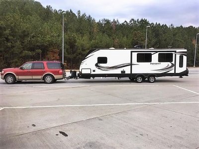

FYI.
I have a 2014 Expedition with HD towing package, 3.31 rear axle, and like yours it has 60K miles with new Michelin's. It weighs 6,300 lbs with full tank of gas and my 240 lbs. My trailer is a 2018 Passport 2890RL, Dry weight 5,650 lbs, Tongue weight 635 lbs, Overall length 33'3" and I have an Equal-I-Lizer hitch rated for 10,000 lbs. The Expedition and trailer total weight is 12,600 lbs. I pull it at 60 mph without any problems, only minimal to no sway when big trucks pass or in windy conditions and I average around 9 MPG. I have the factory brake controller set at 6.8 and have not had any problems stopping. I drive like a Grandpa and am good with cruising at only 60 mph though I have been know to go 65 mph when passing lol. I'm confident and comfortable with my Expedition and trailer combination. Good luck and I hope this helps.

How many washers are you using? I see some squat so i think you might get a little more stability and less waggle if you add a washer or two.

On my 2003 Expedition with my equalizer E4, my trailer has around 800 pounds tongue weight and I use 5 washers. I don't have air rear rear suspension either. It tows wonderful like that. But got a new TV so will have to readjust it come spring.... I bought a diesel Excursion

Thanks for the replies. Sorry for the delay in answering the number of washers question... I have six washers now and I might have to try seven since the amount of "stuff" in the trailer keeps increasing, kinda' like my waist line with all the holiday chow lol.

Wow... 6 washers! I don't think you will need 7? How long is your trailer? What's the tongue weight? I had 5 on mine, and didnt have rear air bags. My factory tongue weight was around 700. I never tow with water in it, since I can always get it at any campground.

I went back and checked the number of washers I have and it's five (5). Sorry for any confusion I should have put my glasses on the first time I counted.
