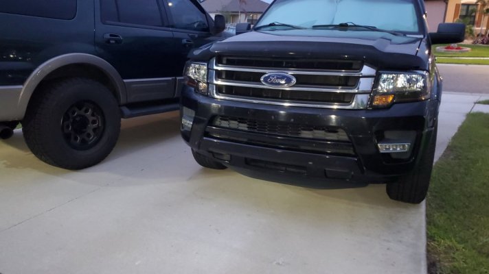

Does anyone have the part numbers for the factory:
Quad Beam Reflector w/ Blackout treatment headlights
Front bumper cover and fog lights
Black grille
Found on XL Model SSV Expeditions?

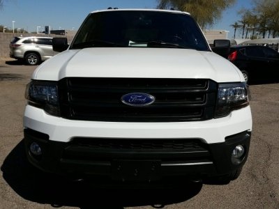

interesting, i was in D.C. area yesterday at Reagan airport and i saw a bunch just like the above picture i just added.

SSV is only available as an XL model.
XL models have various option/rapid spec packages (examples 100A, 101A, 50C, 50F) that regardless of SSV or not will determine the headlight and grille being chrome or blacked out, or the grille body colored.
Blacked out halogen headlights
FL1Z-13008-K driver
FL1Z-13008-J passenger
Front bumper cover is two pieces. The upper section is paint to match, lower is black. This is the plastic only, no hardware, mesh, etc.
FL1Z-17D957-APTM upper
FL1Z-17D957-AA lower
Black front grill - no hardware, no emblem
FL1Z-8200-AA

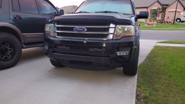

I just got the headlights for my wife's 2016. The original lenses are starting to haze, so I was looking at aftermarket housings. Found this thread. These Ford units weren't much more than $100 more than an aftermarket set (that's backordered and probably from China). Money well spent for OEM IMO. I hope to get them swapped this weekend.
Broncoholic
Jan 15, 2019
178
121
Space Coast, FL
I swapped them out last night in 15 minutes. I think it's a nice subtle change. The units come loaded with new Phillips bulbs, which is nice for the price, but I had already bought SilverStar zXe bulbs based on prior experience in my 2003. Both the Phillips and SilverStar are yellow when compared to the LED fogs, so now I have a set of SeaLight LEDs on the way.

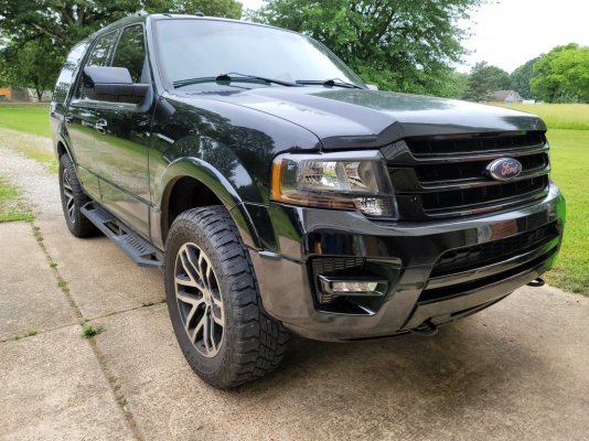

I just got a set. I have a set of FuzedLED lights to go in them as well. I'll post pictures once all the deer damage is repaired.

Actually it is. The set they sent me had halogen bulbs already in it. I ordered the correct LED bulbs and switch backs for turn signals to replace the halogens. I think I can see better with these vs. the same manufacture LED's (FuzedLED) in the projectors. Side note. One came in defective. Didn't look that way from the outside but the internals (reflector) was broken away from the main housing. Even though they sat for months in the box before I found out the company took care of it. Shipped out a replacement asap and didn't even have to go through the hassle of sending the bad on back.
