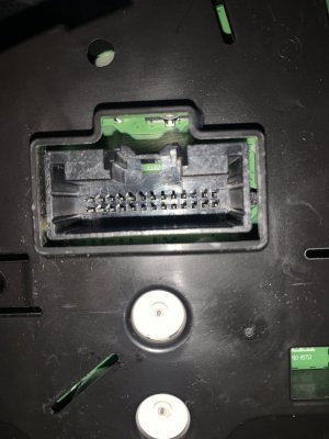

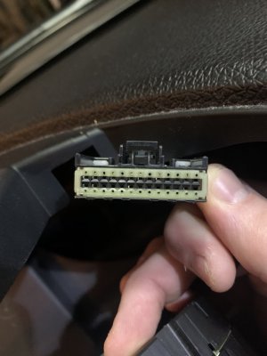

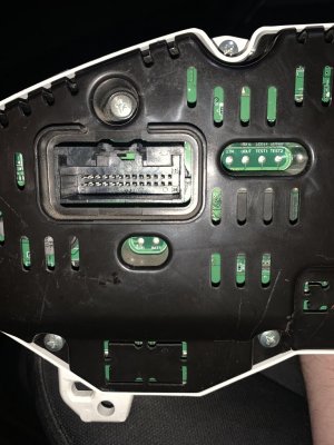

Ok so here is my connecting on the Expedition. The next picture is the dual dial cluster and then the singlet dial. I honestly can’t tell any difference between them. Even the PIN numbers line up just fine. The only thing I can think of is that it has to be VIN coded by the dealership. I called one dealer today and they were a little confused. So I’m gonna call some other ones tomorrow.

I was more interested in wires and wire colors
