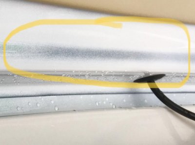

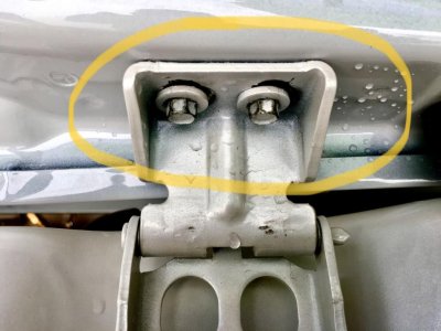

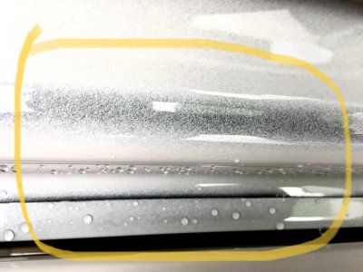

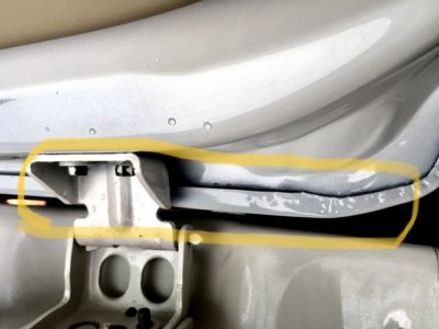

Lift gate gate replaced at a cost of $1243 out of my pocket so far! Dealing with Ford still to see what else they can do! Supposedly, they may still come through and give me a better deal by refunding some or all of my out of pocket expense. I'll update when I have more info, but meanwhile look at the paint work! Primer shows through the clear coat at the top inside lip of the lift gate, and of course the original bolts were reinstalled obviously with an impact gun, and were left chewed up and unprotected by paint like it originally was. How long do you think it'll take for the rust to start there, especially living in an ocean environment? No pride in work anymore!
