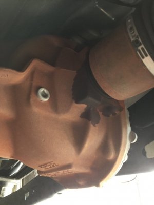

Just had the truck in for its second oil change at 18k and the rear diff has wet stub axles.
Anyone seen similar? The ford tech said it was from assembly and cleaned it well. I'm going to keep an eye on it over the next few months.
I've towed up to the limit with the truck. Love me some ecoboost.
Edit: 3.31 ratio, non limited slip.

I would be weary, but you've already done what you could: Clean it and see if it reappears.

That Ford Tech needs to go back through their program or find another line of work. That is a weeping seal, leaks just enough to be noticeable. Plain and simple it isn't right. If this was a commercial vehicle (semi) the DOT could fine you or shut you down until it was fixed. Take it back in to be replaced if still under warranty. It wasn't like that when you bought it...so don't listen to their bs.
Causes of leaky blown seals - poor machining in rear assembly, out of balance axle(wobbles), vent clogged with mud or bad seal to begin with.

Talk to the Service Manager. Looks like a weeping seal to me. Diff is filled after assembly, so I suspect the Tech is wrong.

I have a 2015 Expediton Limited 4 x 4, purchased new, now with 20,*** miles on it.
I looked at the rear differential after this post and my differential has NO oil on the housing.
I suspect you have a defect that should be repaired under the vehicle warranty.

Thank you for checking. Do you tow at all with it?
