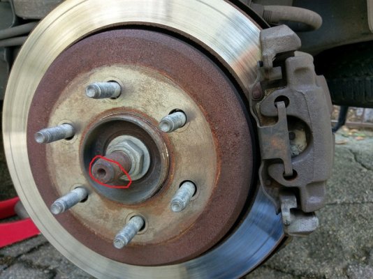

Yup. Any 6-lug Ford wheel should fit.
You might have to trim the end of the axle shaft on the rear.

The F150 wheels have a different backspacing. So your (rear only) axle shaft will slightly poke through the F150 center cap hole not allowing the caps to be mounted. The solution is take a hack saw/sawzall or cut off wheel and trim a little off the end of the shaft. Its very easy and doesn't hurt anything.
A
Ah great. Would it affect the Stock Expedition wheels from being put back on?

Right, that seems to be the information I have found as well. After sketching the profile, it appears that the f150 should fit, except for the previously mentioned axle issue (easily solved).
