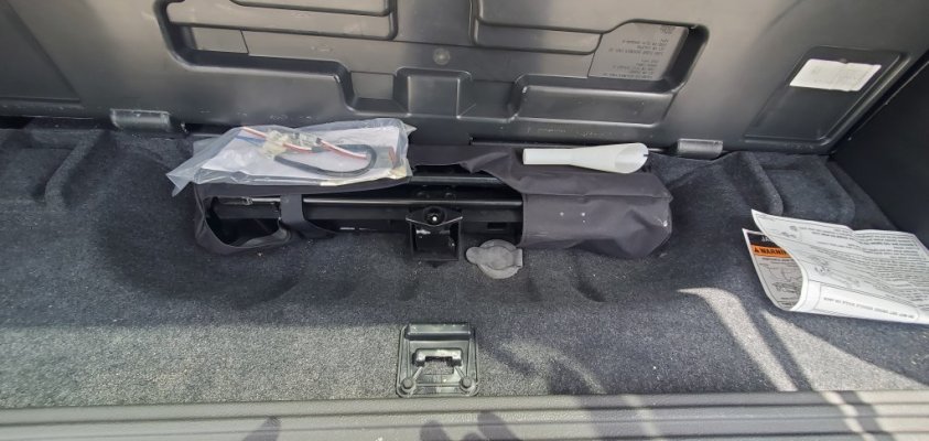

Do you know if the solenoid is opening / closing? If not that could be cause. Could be the vent line or as suggested above, some sort of blockage in the filler neck. Do you have or can you borrow a borescope? If so, you can put the plastic emergency fuel filler funnel (see pic below) into the filler neck to keep the filler flap open (it is in the jack compartment under the cargo area hatch) and feed the borescope down the filler neck to make sure it is clear.
