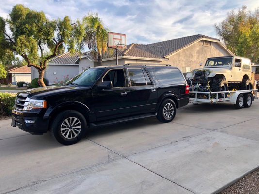

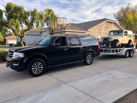

Thanks for this! I’ll keep it handy when it comes time. My transmission temp runs around 200 degrees without a trailer, and after towing about 5,000 lbs up to the mountains from Phoenix in some pretty good heat it only went up to 219. What does your transmission temp run at with the cooler both towing and regular driving?
