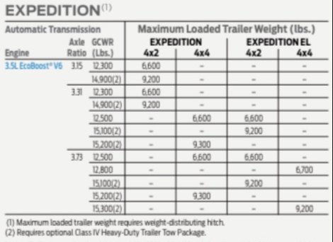

Now I'm more confused. I have a "15" on the side of my door under axle, which I believe means I have the 3.15 axle ratio. The truck is a 4x4. Looking at the below chart from Ford, they don't even list the 3.15 axle ratio for the 4x4. Am I missing something critical here?
That said, even if I do have the 6,600 lb capacity, I'm well within that for this truck. Might be pushing the frontal area limitation. I'll have to measure next time we're out, but if I'm reading this correctly, I've basically got 6' x 6' of space I can safely tow, and I'm guessing my camper is over that. Unless I';m confused on that part too. I'll be honest, I've never heard of that until now.
