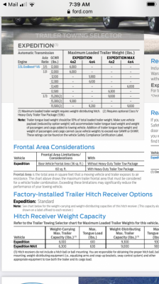

Question for the forum. We have a 2018 with the Class IV tow package. Not HD. We have a horse trailer and need to tow around 6,000lb fully loaded on flat highways within 100 miles maybe 3 -4 times a year. Currently the truck tows with no issues or over heating issues. Temps normal.
How much do people tow with this package? Up to 9,000lb?
My dealer, Service manager told me with the 10 speed and the class IV package I can tow 9,000lb on flat roads everyday. Just mountains and hills would be an issue. Thoughts?

Any modern Expy can tow 9k and beyond so long as you use common sense.

If you don't have the HD tow pkg, your truck isn't outfitted properly to tow over 6k lbs. If your only towing the 6k lbs, you should have no issues with the conditions you need.
