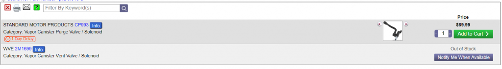

so from what i can tell, there are two solenoids, a purge and a vent. The purge looks to be on backorder, while the vent seems to be available, and is roughly $30, I'd be open to replacing that if the job isn't too hard, I have no idea where that is to be honest.
I would still think that if a solenoid was stuck open or closed, it would fire off a CEL wouldn't it?

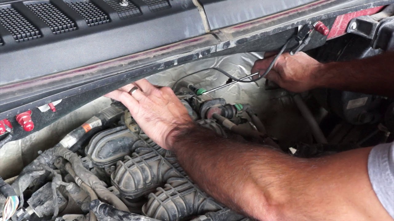

The Purge valve is located somewhere under the hood near the intake (I don't have a Gen 4 so can't tell you where). The Charcoal Canister is located adjacent to the fuel tank and the canister vent solenoid is attached to the canister. But I would focus on the purge valve/
Here is a video that shows how to test the valve, it is for an older car but evidently the valve has not changed. https://www.youtube.com/watch?v=S6dsQoq73aE
