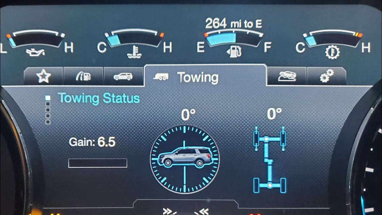

In my 2019 Expy we have the digital screen in the gauge cluster. When we first bought it (used) the screen would always come back as we left it, which was usually one of our "favorites" screens. However, I recently added a trailer to the towing option, and now the towing screen always shows on start-up. This happens even when we shut the car off while on another. Even when a trailer is not connected, the towing screen always shows on start-up. I have searched through the settings with little luck. Has anyone experienced this or know how to adjust/fix?

You need to go in and select 'No Trailer' or something like that.
You probably disconnected the trailer when the vehicle was turned off. Very common issue. I have done it too many times to count. LOL

Thanks Lou. That exactly what I did since I don't like disconnecting a trailer with exhaust blowing in my face. I'll check to see if there is a "no trailer" option, but will otherwise connect/disconnect the trailer while running.

You just need to unplug the 7-pin before you turn off the Expy. You don't have to do a full unhitching while it is turned on.
