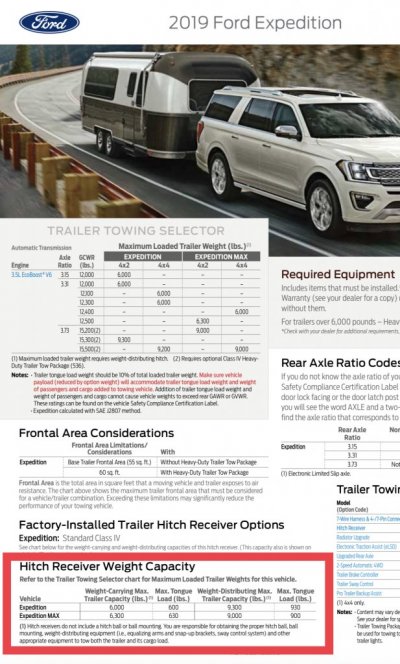

I’ve got a 2019 4x2 Max and per the 2019 Tow Capacity sheet I can pull up to 6,300 (linked below). However, I don’t understand this section:
Are column 3 & 4 referring to models equipped with the HD Tow package? I’m just curious because the column headers for column 1 & 3 are different.
https://www.ford.com/cmslibs/conten.../guides/19Towing_Ford_Expedition_r1_Dec21.pdf
