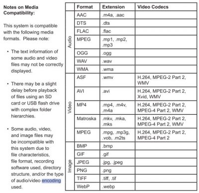

Fizzy - You mentioned in another thread that the manual specifies the encoding method, so here's the table for reference. I'll give it a shot and post back tomorrow or when I have time to try again.

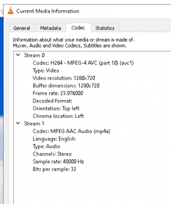

Fizzy - I confirmed the videos are M4V encoded with H.264 so I'm REALLY curious about the format and codec you utilized. Have a good night :)

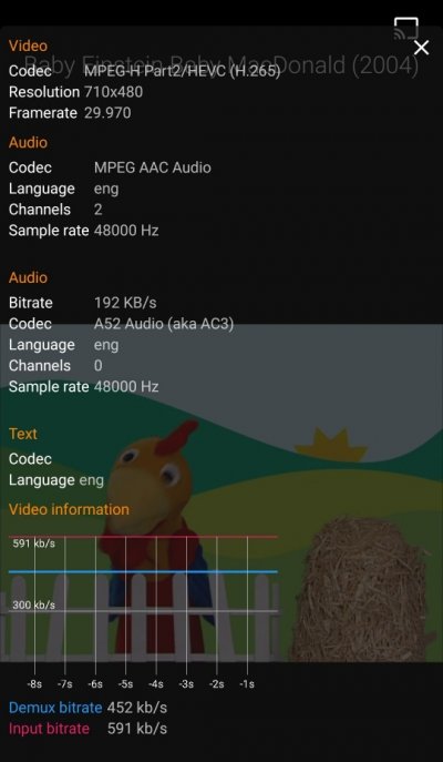

Odd... all my media is converted to the following format, and they all load when I put the SD card in directly to the drivers side RSE screen (no USB):
I'm using the mp4 container, not m4v.
Fizzy
Dec 18, 2020
443
321
Alberta, Canada
I can hardly make it out... but are you using H265?
Edit: Yeah, you're using H265. There's no way these units can cope with that codec. Hell, even some laptops struggle with that.
Use H264. You'll end up with bigger files, but the compression isn't so extreme and doesn't require a powerful CPU.

I encoded two of the same DVD's with DVD Ripper using the MP4 container and H264 codec. The file size tripled, but I can view both MP4's in the Ford/Voxx RSE using an exFAT formatted USB stick. I'll transfer everything to a SD Card when I'm done and try some of the other approved codecs to see if I can get the size down.
Fizzy - Thank you for the assist. I didn't realize H265 was an option in the software so (with the change) I'm good for now!

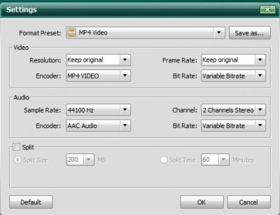

I played around with the settings and was able to reduce the file size from 2GB to 388MB with the following options selected:
I should have plenty of room to spare for music and movies when I'm done switching to a 128GB exFAT SD Card.
