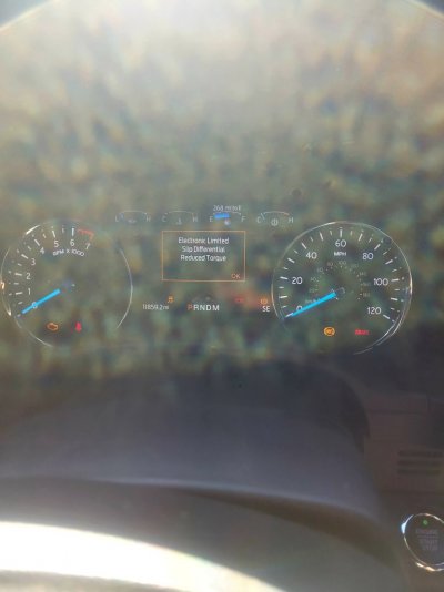

Not it. Auto Unlock works. Kicker is, it does not display no key fob detected. Dash is blank, screen just says Ford.
Headlights flash when you push start

Expedition acted up again dealer can’t locate issue unless it is in a failed state.
showed them a video that shows headlights and dash flickering plus one other that shows vehicle shutting off after opening and closing door
