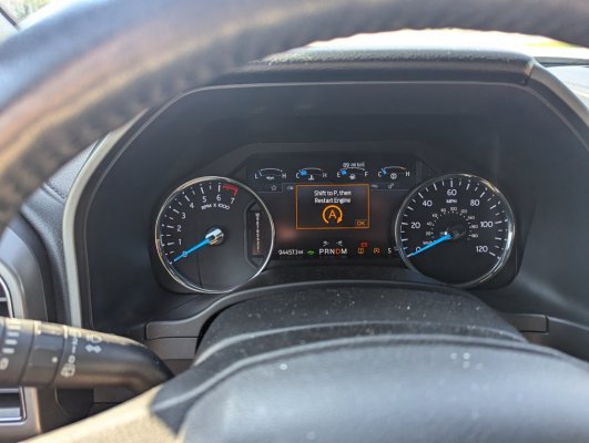

Does it do this?
This is mine during an auto start malfunction. The vehicle tried to start and failed. I think it's a timing related problem. The idle on the engine seems rough, so we are taking it to the dealership to have them fix it. I think (this is me talking), that it's the vvt solenoids...
