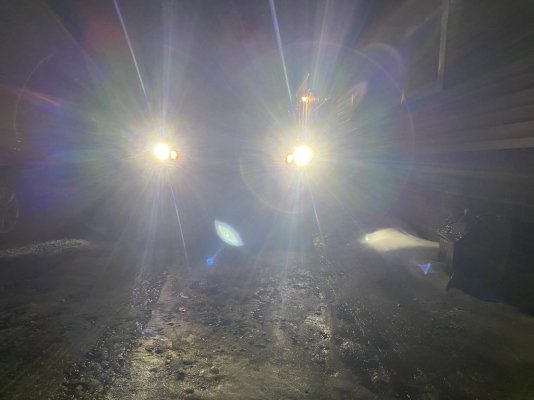

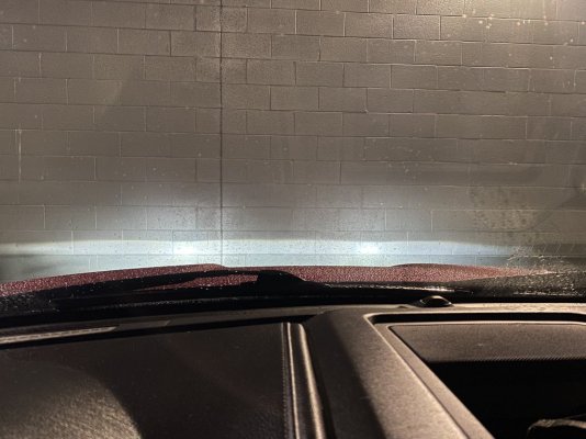

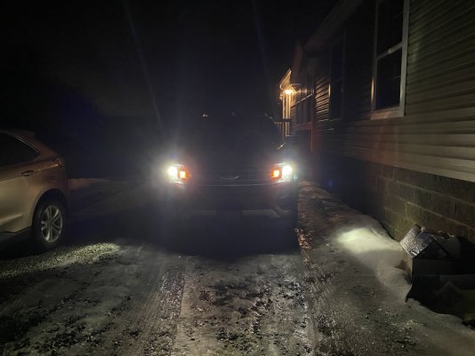

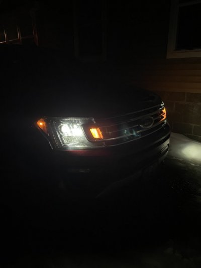

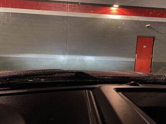

@DWs-TTEB here are some night time wall shots of the Philips Ultinon Pro9000 bulbs.
IMG_8902 is from about 5/6 feet from the wall
IMG_8903 same wall but about 35 feet away
IMG_8904 is directly inline with the light housings
IMG_8905 is from about 15 feet away at capture height of 5 feet
IMG_8906 about 4 feet away.

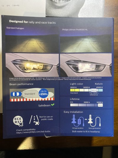

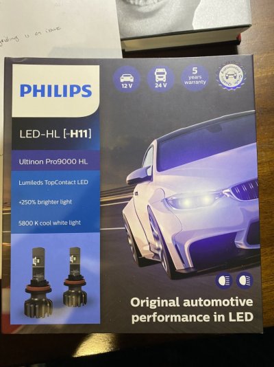

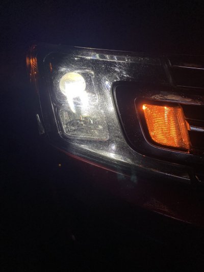

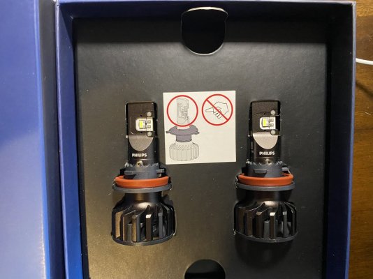

One additional closeup of the light housing and then a few of the Philips packaging materials and the light itself. These are my high beams that I have yet to install.

@apex96 Thanks for sharing these. I now know what my next set of LED bulbs are going to be. I like the light color & the beam pattern. Looks great!

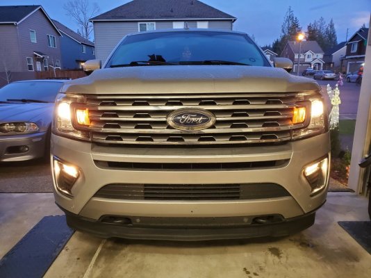

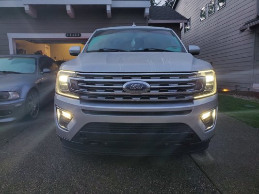

I changed LED bulbs on my 08 F350 and my 2002 BMW z3 and improvement in brightness varies drastically. I was also surprised at how bad the halogens are on our previous Max Limited and so I did the OEM headlight retrofit myself. No, it did not cost me 3k. A pair of good used lights from eBay cost $1K, wire harnesses cost $350 and reselling my old halogens recouped about $575. I post this in response to OP question of anyone having done this before.
I've done LED light bulb replacements before and I did not want to do that with the expedition, to each their own. For me, I wanted the look and performance of the OEM leds.
EDIT: pictures added.

I did the fogs with LED bulbs too to match color temp of the OEM headlights I installed. As shown in the after pictures. Photo doesn't do justice for difference in brightness because camera auto adjusts contrast and brightness.
I went with ALLA lighting switchback white/yellow but regular white works too. Direct plug and play without flickering. If it does flicker, they also have a adapter but in my case I didn't need it.

Many, have gone this route, myself included. But I've had way to many failures due to water intrusion into the circuitry. These fogs sit exposed and down low where it's easy for water to force its way into any improperly sealed wire opening or cheap casting.
Purchasing the sealed housing LED projector fogs that came on select Limited, Platinum and King Range versions will probably provide a longer life span. This option is more expensive but over the past six months I've experienced fog failures of two different brands. I've already sunk $200 into fog LED bulbs already... Also the projector fogs will better match the projector headlights, it may end up being a win win in design esthetics and longevity.
