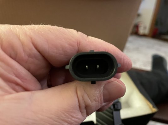

Been awhile since I installed mine. I remember that the manual had a misprint saying the low/high beams are bulb size ***, but in reality what was listed for low was really high beams & Vice versa. So for your issue try putting them were the wire harnesses click have the diodes Parallel to the deck/ground & see how it turns out. I think this happened to me but, 1.6 years has passed.
So you think the bulbs are mislabeled?

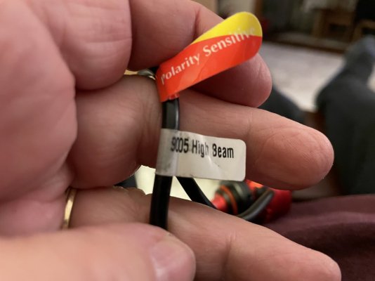

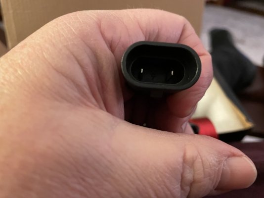

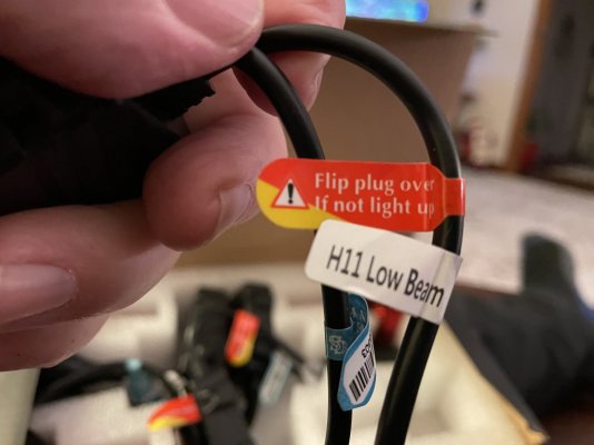

Here are the labels and plugs on both high and low beam. IF 9005 is the low beam you can see they have it labeled as the high beam but the number and plug are the Low Beam, right?A935F415-CD09-4526-A05A-BE5052F1E3DE.jpeg907ECD35-B38C-464C-A7C0-97BAF7A894F9.jpeg
Which then means the reverse for how they marked the High Beam - if H11 is the high beam that is the high beam plug and number but the label says Low Beam?
I think they’re trying to make me crazy!

So, should I send these back or just assume that the label is wrong but the plug is right for the low beam/High beam?
isn’t the H 11 the low beam and the 9005 the high beam? Or do I have it backwards?
If that’s the case then the numbering and label is correct but just on the wrong bulb altogether.
I put the same set in 2 weeks ago. The labels were backwards. I just switched them and threw them in. The housings will only take one of the bulbs, hi and lo have different threads so they only fit the specific ones.
Ok good to know. Thanks.

He’s right. Also if you look at the numbers on the bulbs you took out of the headlight housing you’ll see the numbers are switched from what the owners manual said. On the 18-19 MY this was a thing.

So just ignore the labels and install them as they fit right?
I stopped the installation yesterday so given what you guys are saying, I can just move forward because the bulb threads and plugs only fit in the correct socket regardless.
Thanks for the help!
Yep!

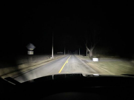

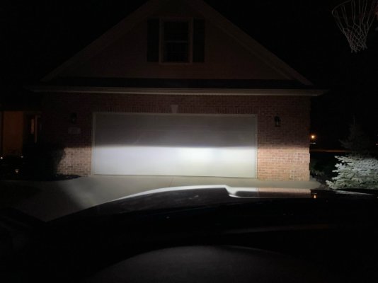

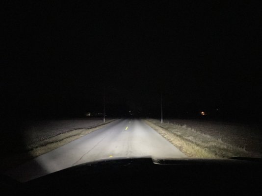

Got them installed today. Once I got access through the wheel well the bulb change was pretty straightforward. But the LEDs are an enormous improvement. See the picture below of the LED on the left and the factory halogen on the right. White light vs yellow.
It’s amazing that Ford would actually put those halogen bulbs in any vehicle.
Very happy with the swap.69EA10B9-60C4-4DEF-9C52-6ADF7C6A99D4.jpeg8535D1EB-A012-4BAF-B2C3-8142FD37DB25.jpeg
Very happy with the swap.View attachment 71744View attachment 71745
How is the night time driving experience improved? Besides being a white light, does it illuminate further down the road? Wider beam?
I upgraded the halogen bulbs on my 2019 XLT, but I still avoid nighttime road trips if I can. Something I never give a second thought in other cars.
Sorry been busy! The difference driving is unbelievable! Brighter, cleaner light with much more light down the road! I’m doing the fogs next for sure!
This pic is the high beams.
