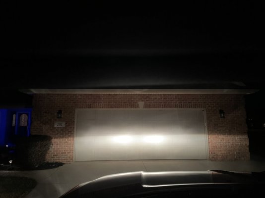

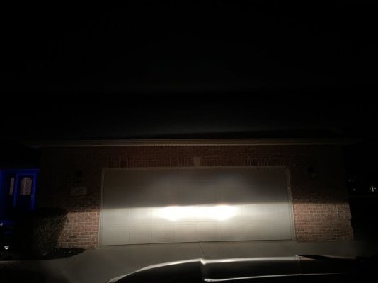

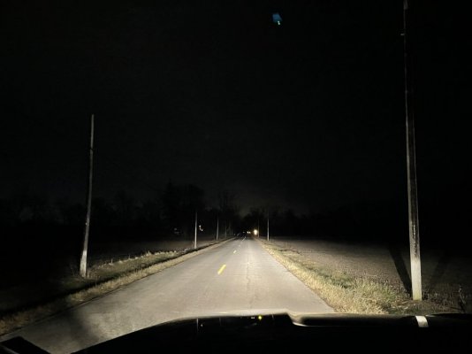

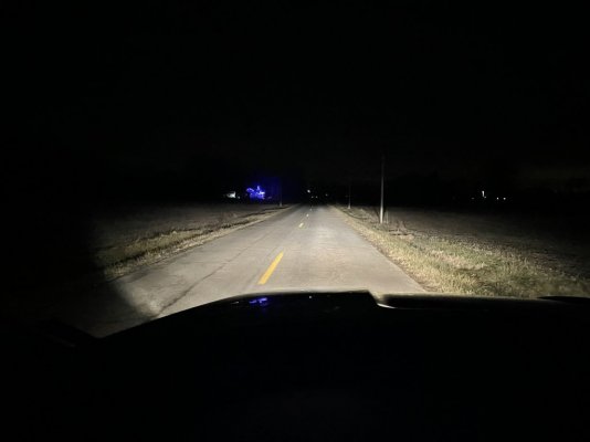

Here are some shots of the factory halogens using my iPhone 12. Somehow it makes the factory bulbs look much brighter than to the naked eye.
IF they were really THIS bright I wouldn’t change them!
Low Beam halogen
High beam halogen

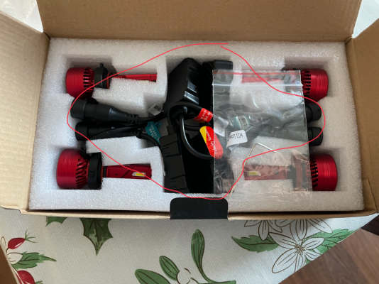

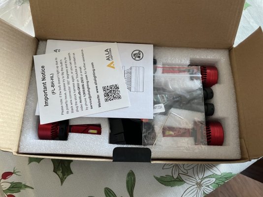

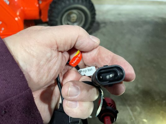

Well no good deed goes unpunished. After considerable effort trying to get access to the factory bulbs - and a trip to the hardware to get a tool to remove a plastic retaining clip holding the wheel liner firmly in place -I find out that the bulbs that were sent to me apparently are backwards from what they should be.
I removed the factory low beam and then pulled the new LED low beam out of the box and after working to get the ends matched up, I find out it will not plug-in at all. Arrrgh!!!
When I looked closer at the plugs I noticed they are not the same. See the first picture.
The bulbs from ALLA that were marked ‘low beam’ have a plug-in that matches the factory high beam bulb and vice versa. Has anyone else experienced this? See the second picture. In that second pic, you can see that although the plug end matches the factory Low Beam bulb, the tag on the new bulb says High Beam.A2B4EABA-ADF5-4787-AB7C-8C7ED86D4E3B.jpeg
Advice?
DWs-TTEB
Jul 19, 2020
746
449
Evans, GA
Been awhile since I installed mine. I remember that the manual had a misprint saying the low/high beams are bulb size ***, but in reality what was listed for low was really high beams & Vice versa. So for your issue try putting them were the wire harnesses click have the diodes Parallel to the deck/ground & see how it turns out. I think this happened to me but, 1.6 years has passed.
