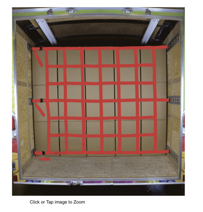

I have the same problem -- and have thought about doing the same thing -- but instead put cargo netting (which can be be ordered to a custom size) for moving trucks etc between the second and third row seats

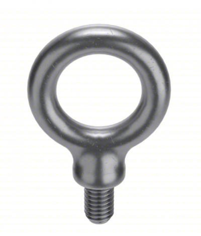

I was thinking of attaching the netting via eye bolts
But question is where (and how) to safely and easily install eye bolts in the frame of the vehicle.

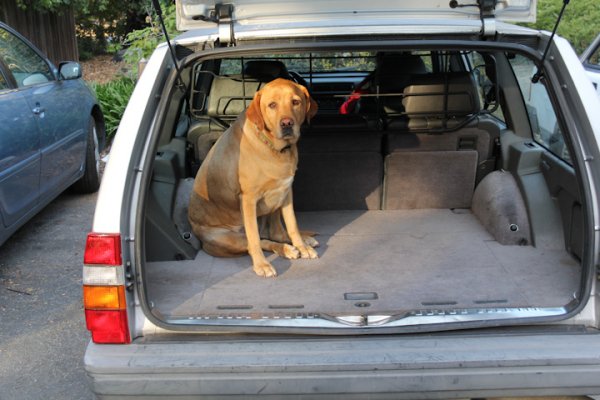

I know this is an older thread, but I lament that modern SUV makers aren't providing factory cargo barriers. My early 90s Volvo wagons had barriers that were sold by Volvo at the dealers, custom fit welded alloy tubing, with spring loaded hinges from the roof, so you could swing the barrier up and out of the way when you're putting the back seats down or something. They were sold as much to keep luggage from flying around in a crash as to contain your pets. Example of one of these with my ol' yellow lab Maggie ready for a beach day... Vehicle is a 1993 Volvo 740 turbo wagon, picture is from 2011.
