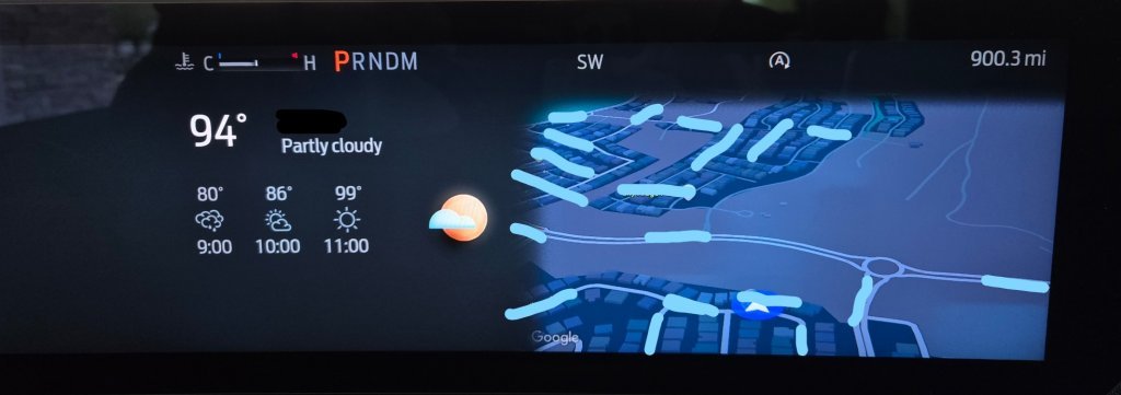

Attached is the pic of my 24" screen. Manual says the ambiant temperature should display on the top ribbon to the right of the compass. Can anyone verify. I am not interested in the widget as it is not my real time location temp. I have done a soft reset and that did nothing.

Try removing the widget or replacing it with a non-weather widget. The software seems to have some quirks where it takes away certain things depending on other settings. i noticed that with one of the speedometer colors/themes that has a compass integrated into it the compass direction above the mini map went away.

Thank you!! Exactly what I needed to do. Once weather widget was replaced the temp displayed!!
