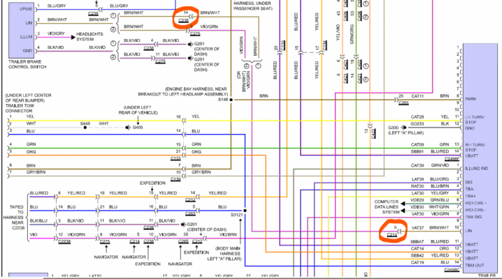

Thanks for posting! I'm not used to reading these. How do we figure out where C238 and C214 are and what they look like?

In the back of the Service Manual it will show the locations of the wire harness and the connectors. Here is an image for the 18-21 I took a screen grab for...maybe someone with the '22 will help you.

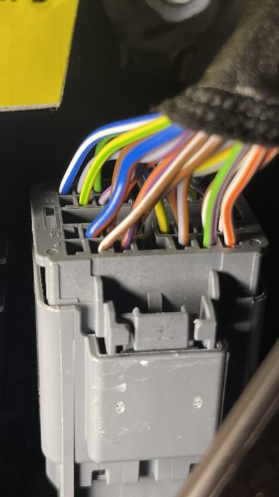

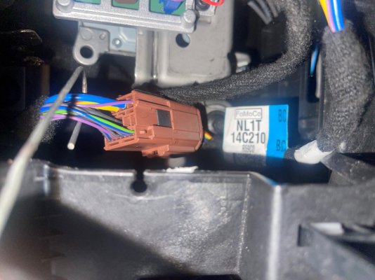

From a 2022 KR with Class IV Tow Prep Pak and not HD Tow Pkg. C238 is brown - behind control switch in dash. - that's what the switch pig tail plugs into. C214 is Gray in passenger floor side kick panel also shown to the right of fuses slightly hidden.
C238 in dash behind control switch.jpg C214 Passenger floor side panel.JPG C214 Right of fuses.JPG
You can see brown white wire in top of C214 that goes to C238. The bottom does not have the wire (pin 5) - that's what would connect to the controller by the steering column. The diagram does not show any additional connections so the purpose of this brown/white wire is to connect the control switch to the controller. I'm going to do what JohnsonEJ23 said, splice into the switch brown/white in the dash and connect to the controller about 3' away rather than picking it up in C238 and routing it across to the other side behind the dash.
