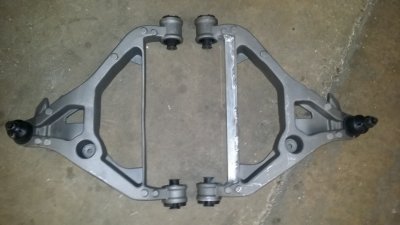

I was told by the owner of an offroad shop in my area that he had a dude that was able to use the upper/lower from an F-Series truck and it only required a minor modification of some sort however, he didn't have any details.
I did get the Supreme Series lowers from Movotech and then had my fab guy gusset them.

I bet they are stronger now with those gussets!

I would speculate that anything Moog makes in the USA is far superior off the shelf to Chinese Movotech with or without modifications.
Your truck is Bonnie eh? She and my Betsy could be friends!
They should be however, I'd like to fab up some boxed CUs.
