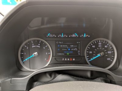

Nope, not even close. Ten speed transmission makes the 3.73 diff irrelevant. I'm at 22.5 mpg this tank. Awesome.
